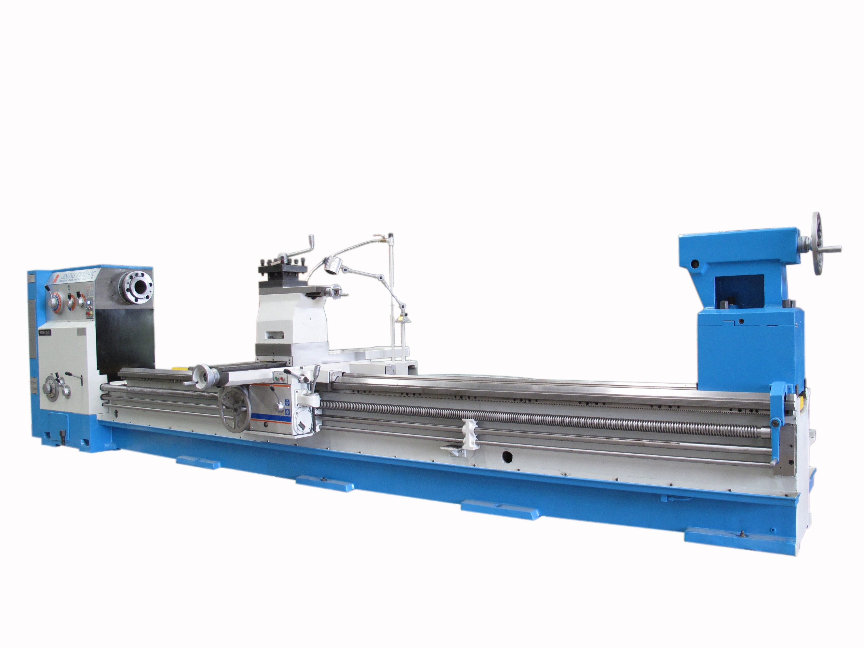

PRODUCT FEATURES:
1.Precision ground and hardened bed ways
2. The spindle is supported with precision roller bearings
3. Head stock gears are made of high quality steel, ground and hardened
4. Easy operating speed change levers
5. Easy operating gear box has various feeds and thread cutting function
6. Rapid feed structure is available on Apron.
| MODEL | UNIT | CW61(2)143C |
| Swing over bed | mm | 1430 |
| Swing in gap(only for gap lathe CW62143C) | mm | 1600 |
| Swing over cross slide | mm | 1100 |
| Distance between centers | mm | 15,002,000,300,045,000,000 |
| Length in gap from face plate | mm | 380 |
| Spindle nose | mm | C11,D11 for optional |
| Spindle bore | mm | 105,130 for optional |
| Spindle speeds | rpm/steps | 7-576/18 |
| Cross slide travel | mm | 715 |
| Top rest travel | mm | 300 |
| Rapid traverse | mm/min | Longitudinal Axe Z: 3200 |
| Cross Axe X: 1400 | ||
| Quill diameter | mm | 120 |
| Quill travel | mm | 270 |
| Quill taper | MT6 | |
| Bed width | mm | 610 |
| Metric threads | mm/kinds | 1-240/53 |
| Inch threads | tpi/kinds | 30-2/31 |
| Module threads | mm/kinds | 0.25-60/42 |
| Diametrical pitch threads | tpi/kinds | 60-1/2/47 |
| Longitudinal feeds | mm/r | 0.07-16.72 |
| Cross feeds | mm/r | 0.04-9.6 |
| Main motor power | kw | 11 |
