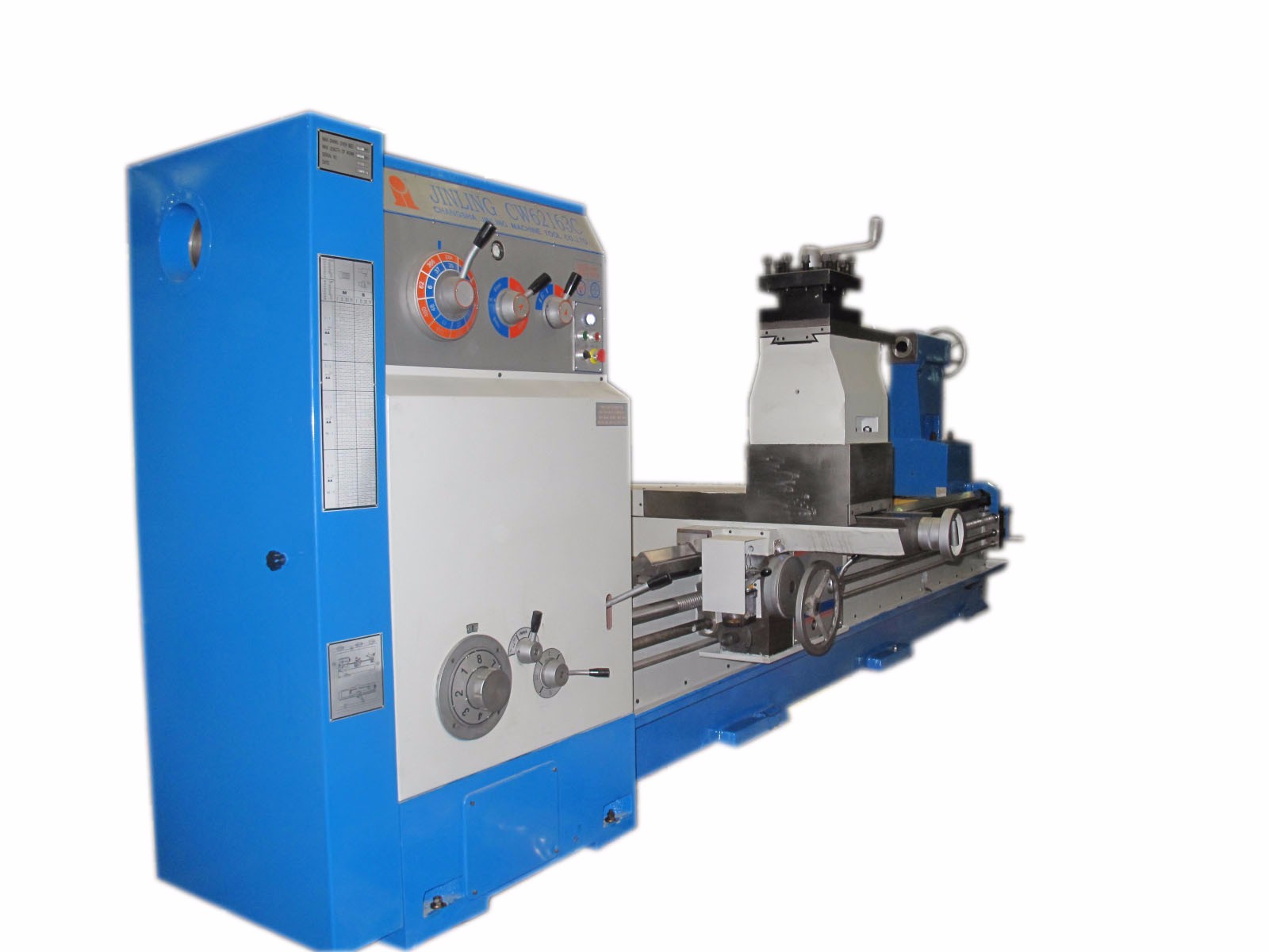

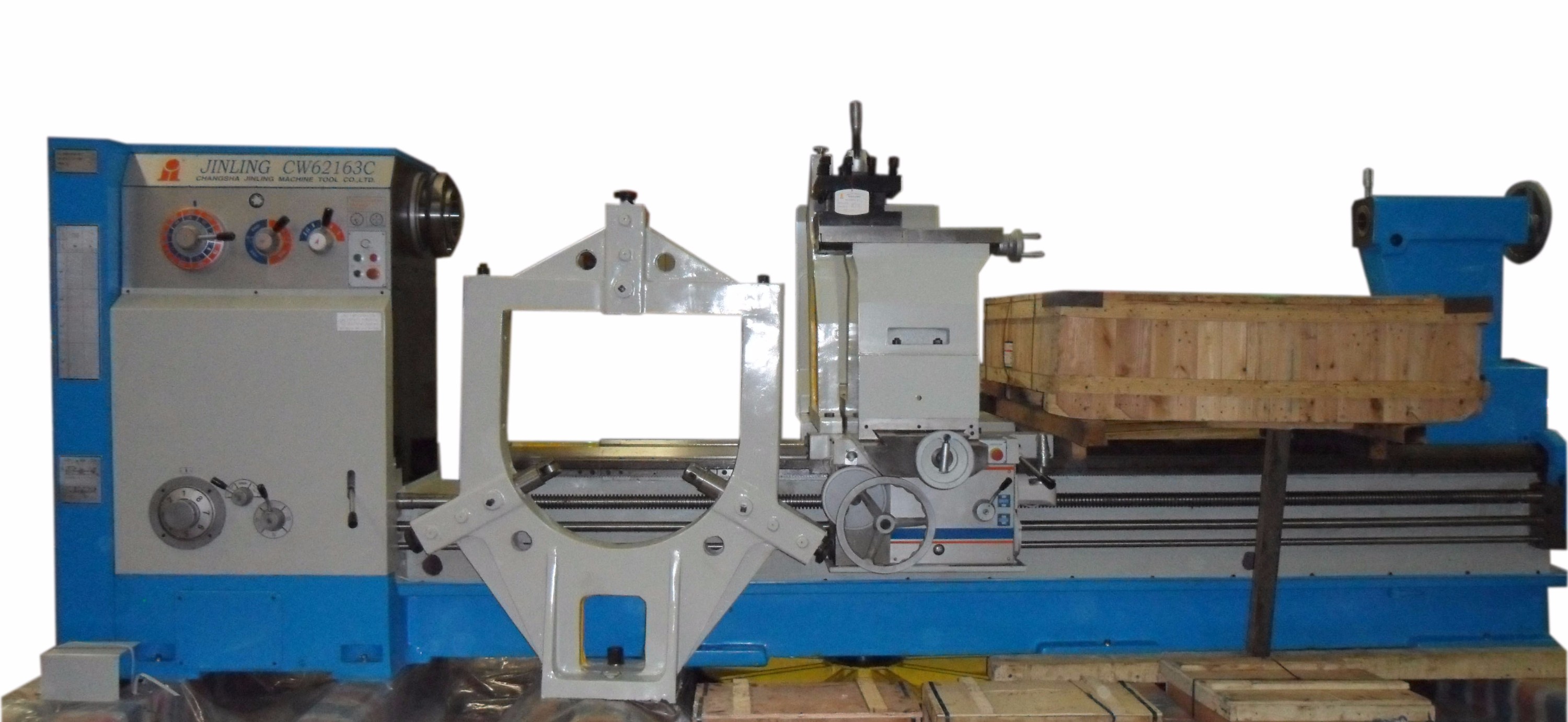

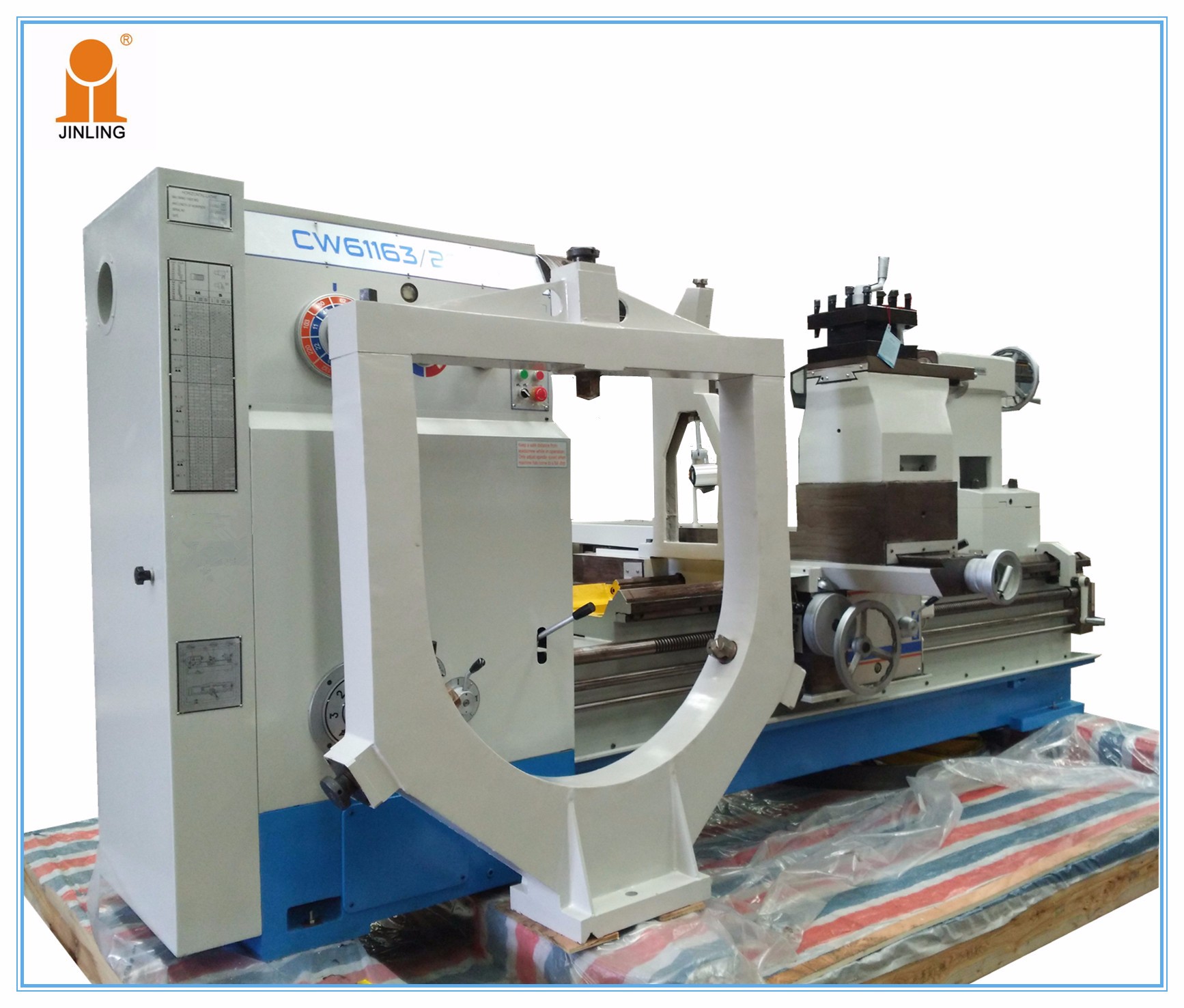

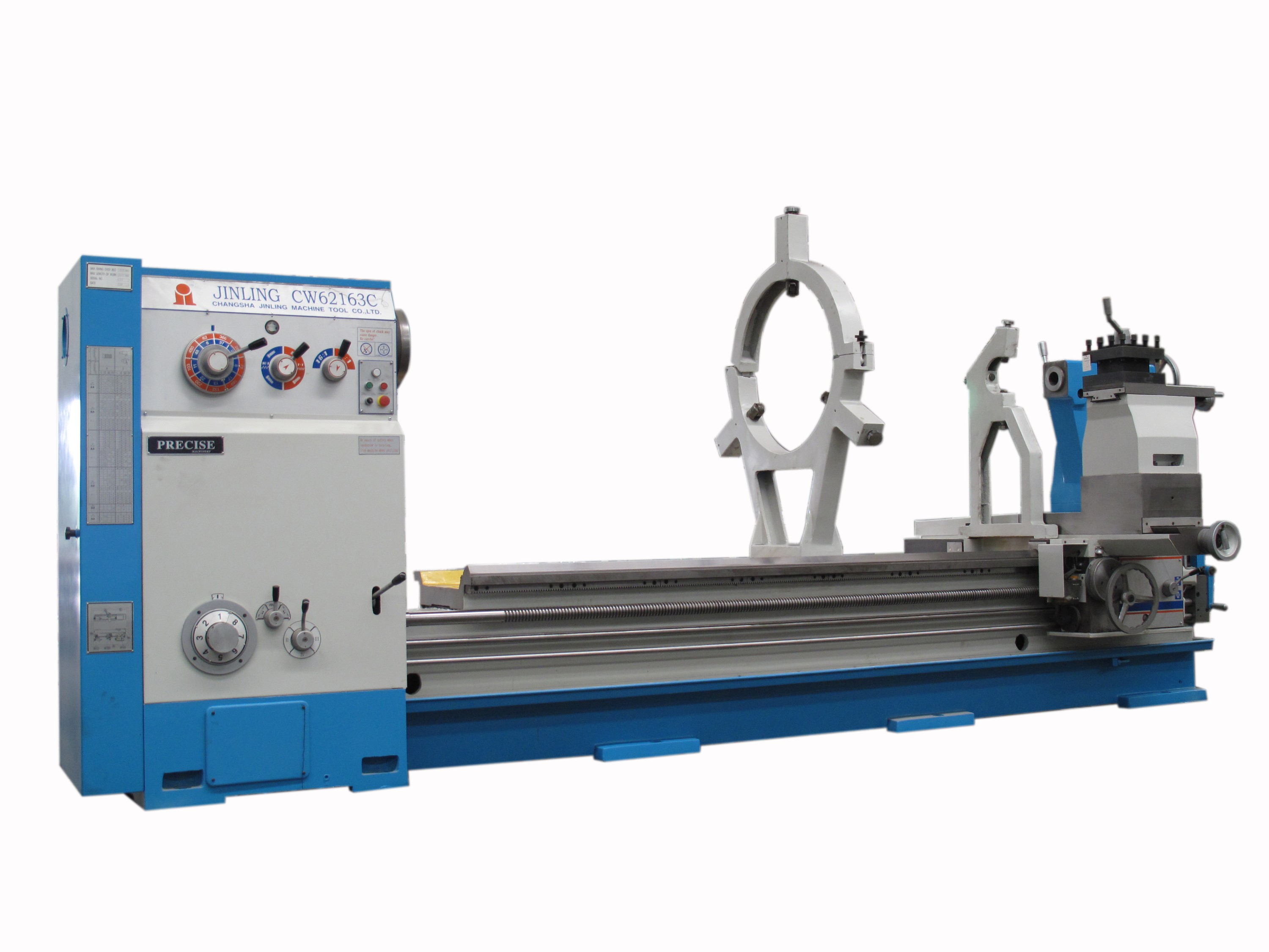

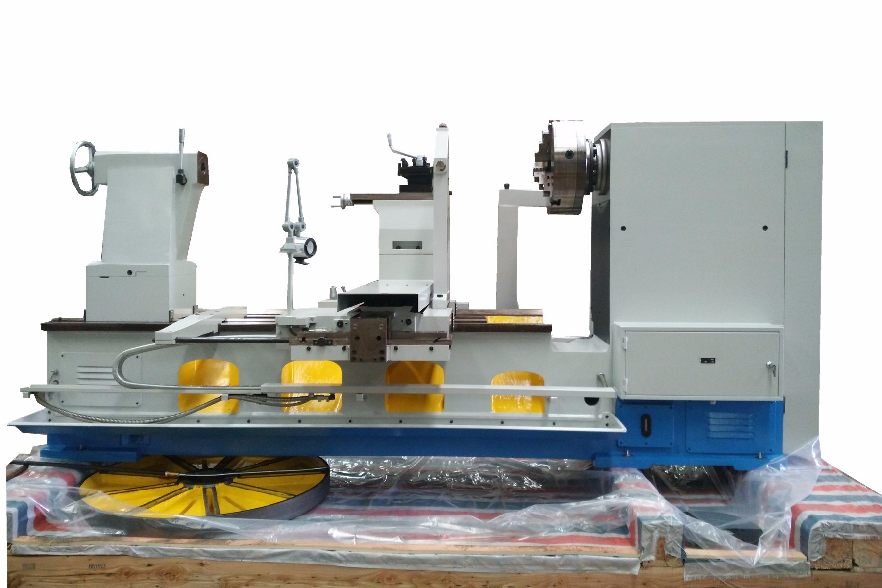

CW61(2)163C
Products Detail
PRODUCT FEATURES:
1.Precision ground and hardened bed ways
2. The spindle is supported with precision roller bearings
3. Head stock gears are made of high quality steel, ground and hardened
4. Easy operating speed change levers
5. Easy operating gear box has various feeds and thread cutting function
6. Rapid feed structure is available on Apron.
MODELUNITCW61(2)163C
Swing over bedmm16830
Swing in gap(only for gap lathe CW62163C)mm1800
Swing over cross slidemm1240
Distance between centersmm15,002,000,300,045,000,000
Spindle nosemmC11,D11 for optional
Spindle boremm¢105, ¢130 for optional
Spindle speedsrpm/steps6-480/18
Cross slide travelmm815
Top rest travelmm300
Rapid travelmm/minLongitudinal Axe Z: 3200
Converse Axe X: 1400
Quill diametermm120
Quill travelmm270
Quill taper
MT6
Bed widthmm610
Metric threadsmm/kinds1-240/53
Inch threadstpi/kinds30-2/31
Module threadsmm/kinds0.25-60/42
Diametrical pitch threadstpi/kinds60-1/2/47
Longitudinal feedsmm/r0.07-16.72
Cross feedsmm/r0.04-9.6
Main motor powerkw11
